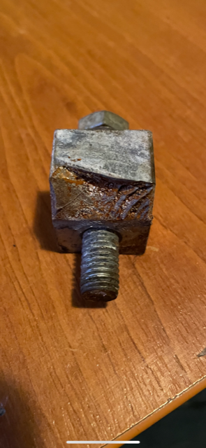

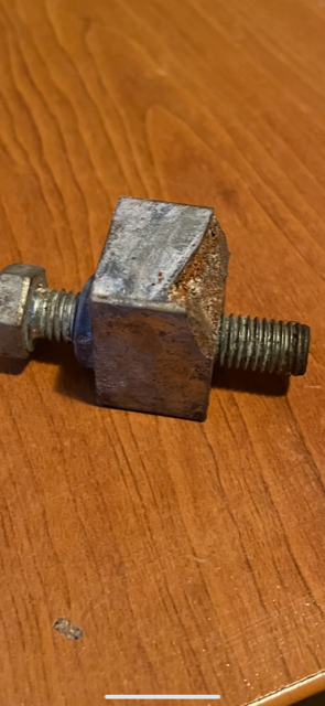

This is a new one for me.  I replaced one of the liftmaster motors a sub 300m with what I thought was a genuine one but is in fact a motor made by IDRO.  Its 12 month since install and yesterday gates were closing but  side on right as you look out was moving about 6 inches farther than left when in the closed position.  I opened the motor covering and found that the gate     stop had broken in half!!  Here are 2 pics.
What would cause it to break so soon? Wrongly fitted or ..
I bought this part from easygates in April 2021 but fitted with new motor April/may 2022.

it could be that your force is set too high on the motor causing damage to this part.
it also looks like the stop has corroded may be due to water ingress and that could be weakening the part further until it fails.

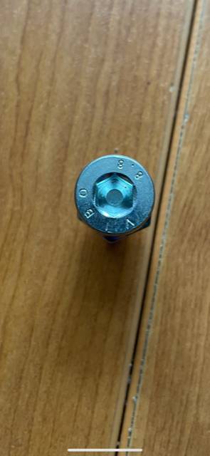

Thanks for reply.  I have gone back to where I got that IDRO motor and they have sent a gate stop set i.e one for front and one for rear.  I want to change it myself but the bolt for the front gate stop has a hexagonal head and after trying 3 hardware shops today I cant find the correct type of key, it looks like an alun but a bit different. Here is a pic and would you know name of tool/key required and maybe I can get it online.
After further searching I think its a HEX SOCKET IS BEST is it 8mm or 8.8mm?
