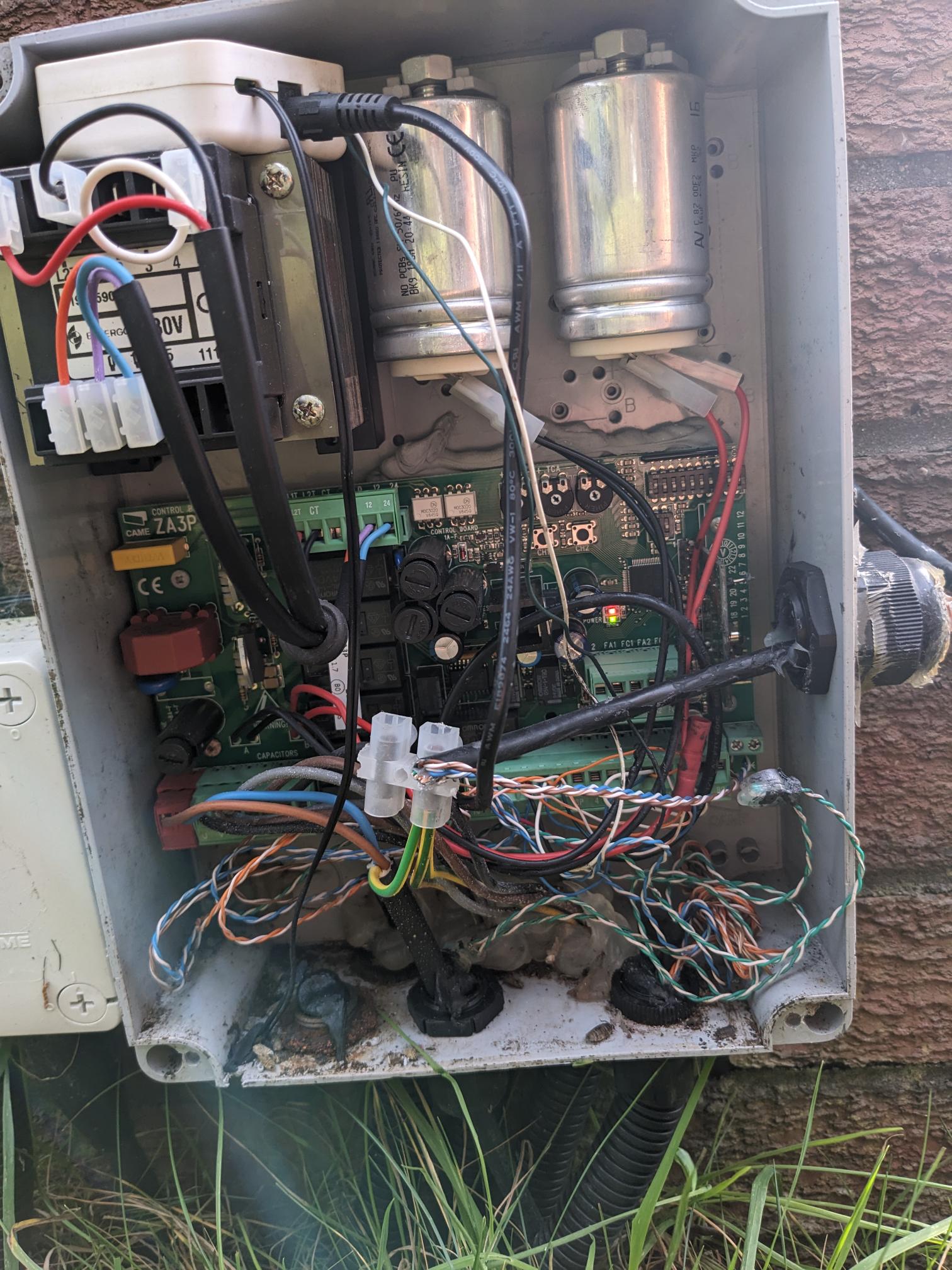

My gate is suddenly no longer closing. There is power to the gate as I can hear it humming and when I press my fob to close it there is the slightest movement but something stops it.
I opened the Came unit as per attached picture and the programme light (red) is flashing. I have four photo cells (a set on either side of gate) but only one is clicking when I wave my hand over it. Could this be the problem? I was wondering how I disable the sensors / override them to check if that helps but I'm a novice. The board is ZA3P. Any help appreciated thanks
