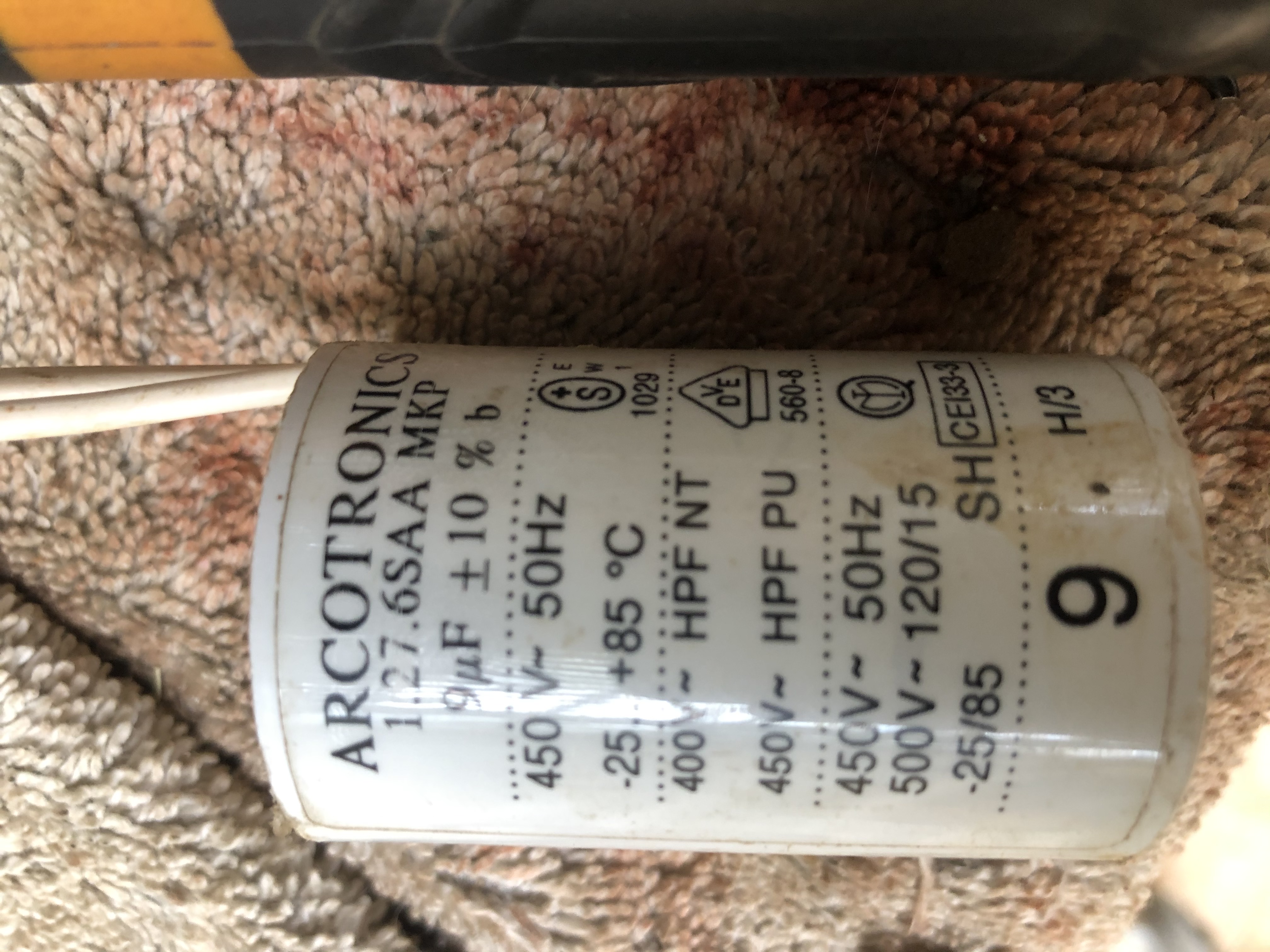

For Beninca swing gate's - i have diagnosed 1 of the 2 capacitors to be the problem. switched the capacitor in between - the 2 doors are function good.
capacitor type:
ARCOTRONICS ; 1.27.6SAA MKP ; 9microF ; 450V ;50Hz
attached image.
I have try using fan 10microF capacitor - it do not works and motor "hamming"
