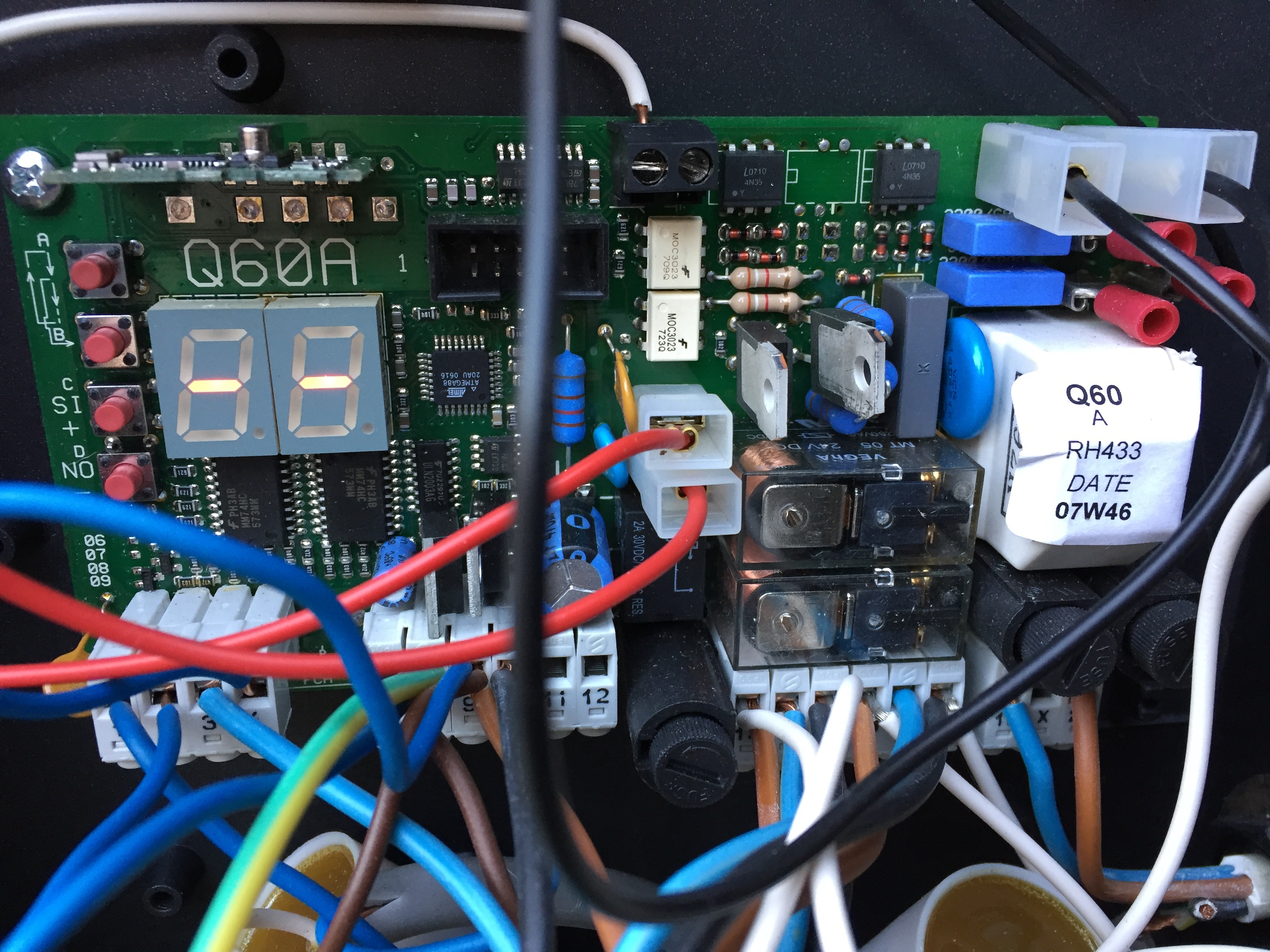

I've got a Proteco ACE gate system with a Q60A control panel, but the radio range is very bad. I'm looking to install an aerial, but unlike the Q60A manual (http://manuals.easygates.co.uk/PDF/misc/mygate.pdf), I don't have the white/red/black radio panel. Instead it looks like there are five unconnected points on the board, just above the Q60A, and a smaller circuit board above (picture enclosed).
Is it just as simple as soldering on the core of the co-axial cable onto the fifth point (just above the '1') and the shield onto the forth point (above the 'A')?
I'm guessing that there is a bit more too it (e.g. what should be connected as the 'white' and 'red' if the shield is the black). Any advice would be greatly appreciated!
Many thanks Smile

Thanks for your reply. I understand the aerial cord only has two wires, I'm just wondering where to attach them! There is no aerial at all that I can see at the moment...
on the top you have black double terminal left is core right is shield
there is istaled one white 1,5 mm wire and that is totaly mistake ,you should use rg58 aerial wire
if that problem with range just hapened with out any reason ,probably radio is finish

Thanks alot Automatic-TC. That white wire is only about 5 cm long and goes no-where... I suspect an aerial will sort it out. Thank's for you help - saved me time and money
