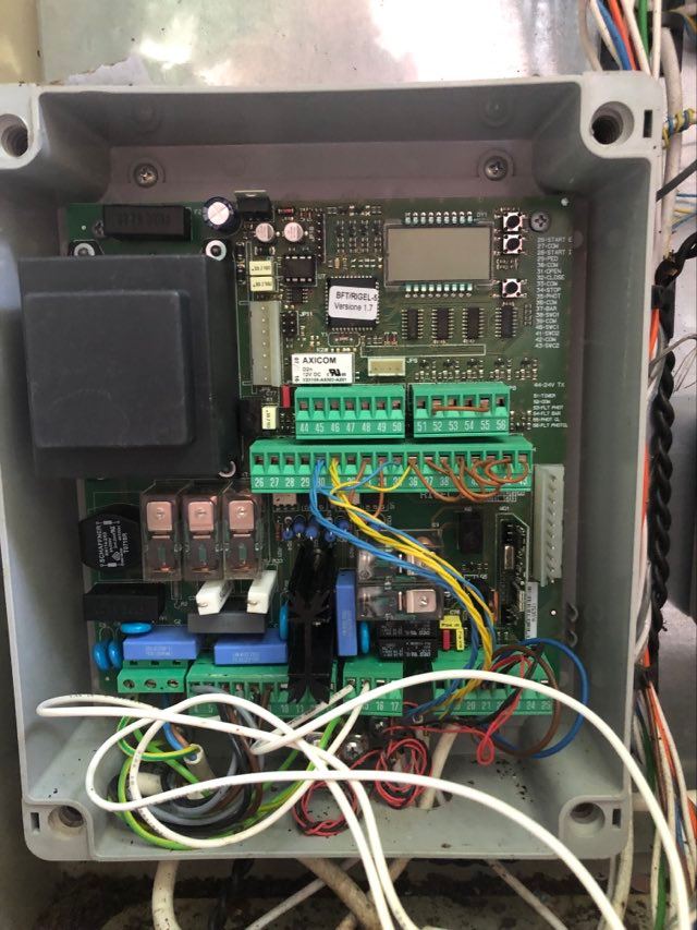

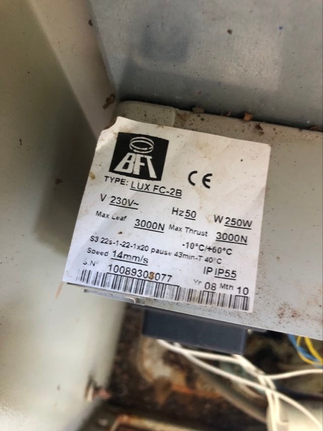

Hello I have the Lux fc 2B I tried to upload some pic
I think I need to change the running time but can’t find a manual to show me how
I will try send pics Monday when I get home.
(12-08-2022, 04:04 PM)jc.34@outlook.com Wrote: Hello I have the Lux fc 2B I tried to upload some pic
i think i need to turn of the slowing down bit as its not suppose to slow down i have been told and then it will have more time to open but have no idea how to do that
hello ben if you could explain how to turn of the slow down bit if you are able that would be amazing
i think this arm or control panel has 17 seconds to open ?? if it spend 4 or 5 seconds slowing down thats were i am losing the time at a guess
