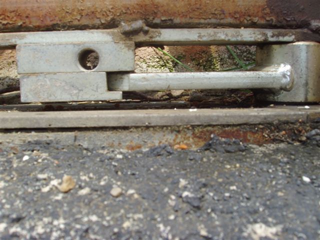

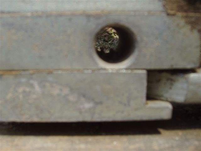

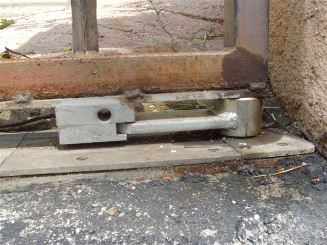

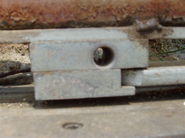

I need to get a manual release key for my electric gates but cannot identify the make. The release key hole is a hollow cylinder with two ridges inside. I attach some pics which may assist. Could anyone tell me what I'm looking for and where I might source it?

Hi Gerry, looks very similar to the Proteco make of gground motor, i do have some release keys in the factory, if you could measure the diameter of the hole to double check the keys i have will fit?

The diameter of the hole on the gate is 15mm.

Hi Gerry,
Thats the size of my release levers i have, PM me your address and i will send you one,

For you information Gerry
The releases and motors and releases you posted are the saimatic sub motors
as seen here
http://www.theelectricgateshop.co.uk/lat...=&offset=0
replaced 2 of these motors recently
