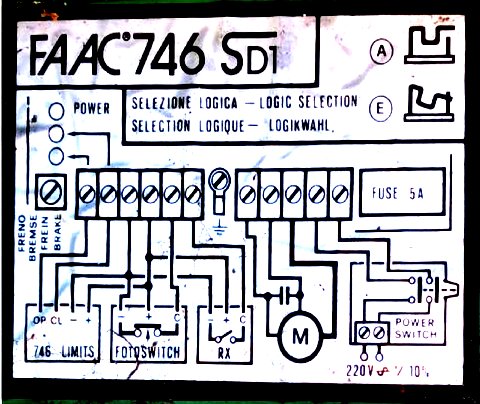

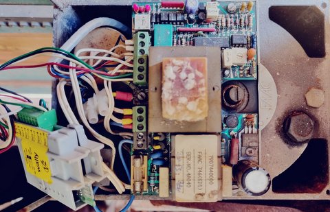

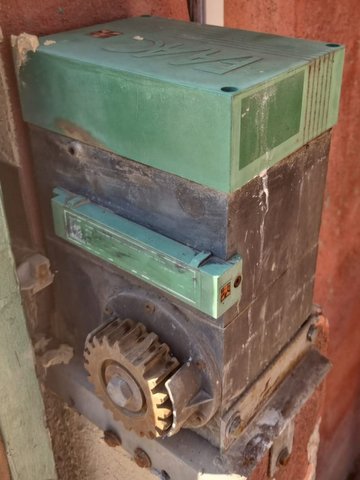

This is an old model (FAAC 746 SD1), I uploaded a photo of the engine and the control panel. Hoping that you will help to see what the next steps are in diagnosing the cause of the problem.
How can you bypass the remote control and start the engine manually?
I would be happy to receive assistance and try to solve the problem with your help.
So today I was able to open the gate manually by bridging point 2 to point 6.
I also discovered that the receiver of the remote does not receive the voltage of 12V that it should receive, therefore it does not work.
Now I ask myself how to fix the problem that there is no power supply from the control board, and is it possible to use an external power supply to power the gate?
(03-12-2024, 12:21 PM)Kipod Wrote: So today I was able to open the gate manually by bridging point 2 to point 6.
Have you checked the fuse for 12V power supply? You can also use external 12V power supply but check the fuse maybe you just need to replace it
