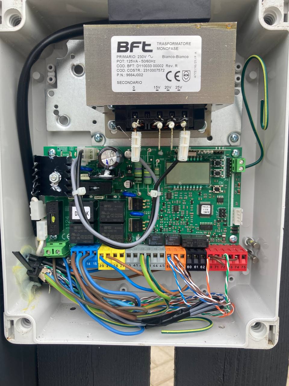

I am trying to draw port from ports 50, 51 which should provide 24V, however there is none. I checked all the fuses, and they all seem to be good. What else can I check?

(20-08-2024, 06:24 PM)tjomk Wrote: I am trying to draw port from ports 50, 51 which should provide 24V, however there is none. I checked all the fuses, and they all seem to be good. What else can I check? Hi, If you have metered for voltage and are still not getting a reading between the two contacts then it sounds as if the 24V outputs must be faulty. Jake

You will possibly find that they energise when the gates are in operation and shut off again when they stop. They should not do that as terminal 52 is the one that is set to safe but mine was exactly the same and I had to take a separate feed for my ground loop, which needed a permanent supply.
