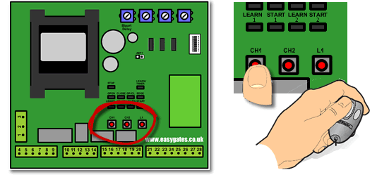

How to program remotes into the liftmaster CB11 control board (which comes with SUB kits and LYN 230V and SCS230V kits).
To program your remote to open both leafs, open the control panel ( Beware of mains wires ) and click CH1 on the board, then press the button on the remote you want to use to open both leafs. For a single leaf gate repeat the process but instead of pressing CH1, Press CH2 instead. For additional remotes repeat this process, leaving 5 seconds after each time you learn a remote.
