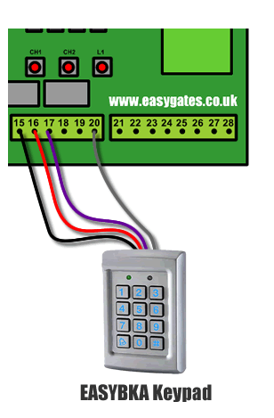

Have wired up the keypad to cb11 as per instructions, keypad lights up and i can change codes etc, however what do i need to do to get the gates to open from the keypad, does the cb11 need to te taught same as the remote control and can you give me full instructions on what to do. Also the buttons on the keypad seem to be a bit fiddly, sometimes they beep when you press them and sometimes they dont
Guest Wrote:Hi there,
Hi, The easybka does not have to be 'taught' as it is not wireless. the relay output of easybka needs to be wired into the start circuit of the CB11. i have attached a diagram how to do this.
Please let me know if you require more assistance.
