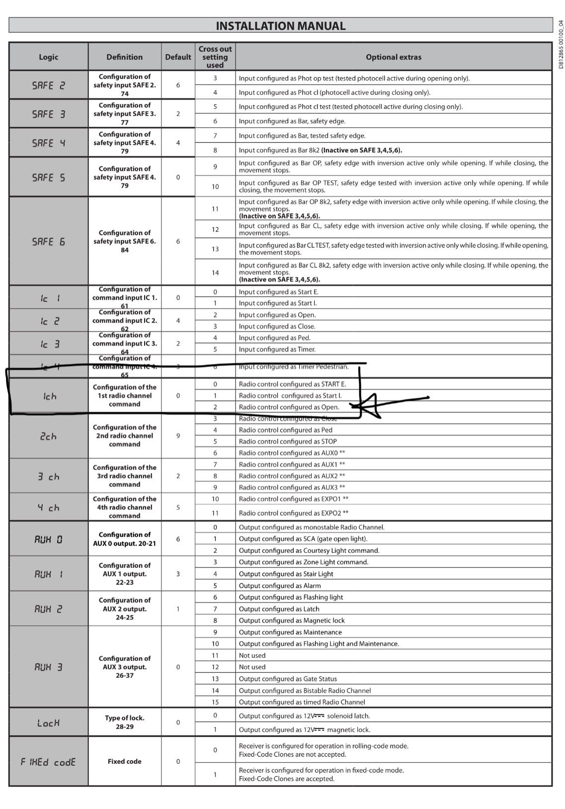

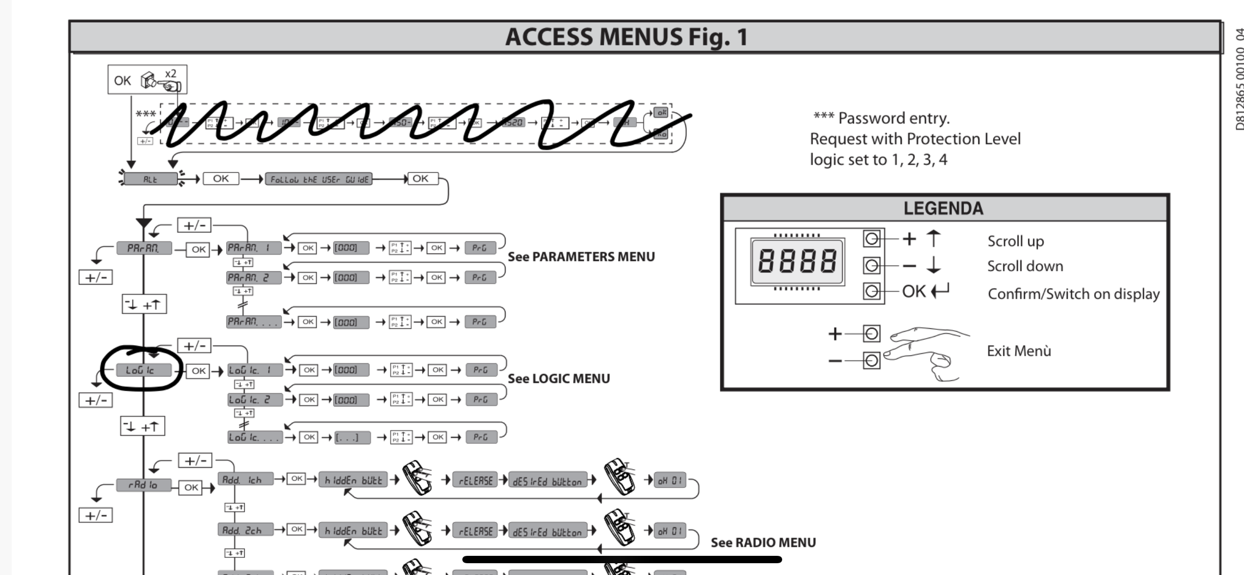

This will be done in the parameters. You will need to go into the "logic" section and change "1ch" from "0" to "2". What this is doing is changing the logic of the remote from step by step to open only.

Sam’s method worked. Setting it to “open” still means the gates close after the Tca (automatic closing time).
All is covered on the manual. Extracts attached. I’ve scribbled out the password section as we don’t have one set (which is the default setting)
