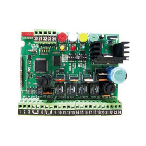

hello folks... how do I programe new remote on this control board?
It's SIRIO 3 12/24 and the remote is TX4 ACM .
I have one that working and
the one new, just need to programe it. I've got the instruction ,but
it's for eagle central unit,not working on SIRIO! But The remote is the same
on both gates...what can I do? help please???
This is a Prastel panel and would normally have a prastel receiver card on the left hand side. If you have SIRIO remotes operating on this board, there will be a separate stand alone receiver which has been hard wired into this board somewhere. Most likely in a separate junction box near this control panel! If you get the model of this receiver I should be able to research the programming instructions for you.
Kindest regards,
Dave

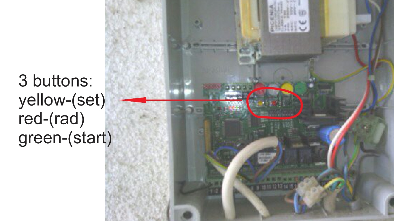

Here is one more picture:
I didn't find PRASTEL anywhere, just SIRIO and that is the only box near gate... there is a 3 buttons: (set,rad and start), does it mean something to you?
best regards Smile
Yes! I solve this! I found manual and it works! Here it is so everyone could see how to do it!
