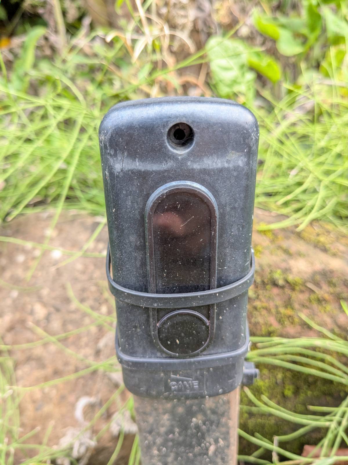

Hello, having trouble with a system I took over after buying the house. Gardener got a bit too excited with strimmer and pulled cables (badly put together in first place!).
I got it opening on command and one set of photocells will cause the gate to cease closure phase and re-open (good).
However, the second pair of photocells is not working (not even a local click sound), how should I have two sets wired up? I want them both to cause the gate to reverse closure and fully re-open.
Bonus question: the electromagnet is not working either, how should that be wired up? There seems to be some kind of additional "mini transformer" or something, floating in the box, separate from the ZA3 PCB, with a few red and black wires attached to it.
Many thanks in advance!

if you have 2 photocells can you confirm the model as Came supply different types of photocells that utilise different technology. have you tried Came Technical support team?
(19-07-2024, 09:18 AM)JoeF Wrote:
(16-06-2024, 07:14 PM)merefield Wrote: About as helpful as a generic superficial answer from ChatGPT Wink
No I need more detailed instructions for the two pairs of photosensors.
Thanks for the message.
Thanks Joe
They look very like Came DIR10 10m Photocells.
No I've not yet approached Came directly.
(The one in the picture is working btw, it's the other pair that isn't and I suspect wiring/setup)
