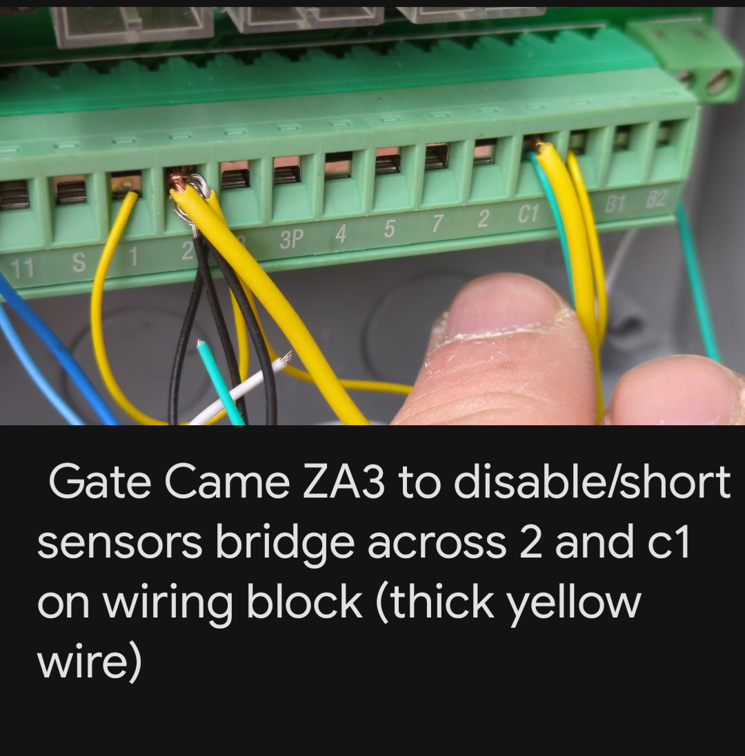

Hi, I just replied to your email about my problem. Just to add to that, in case you were unaware, the picture I've attached shows you how to disable the sensors in order for the gate to close.
Bridge across 2 and C1
Use this info with care as obviously it will still close regardless of what is in the way.
