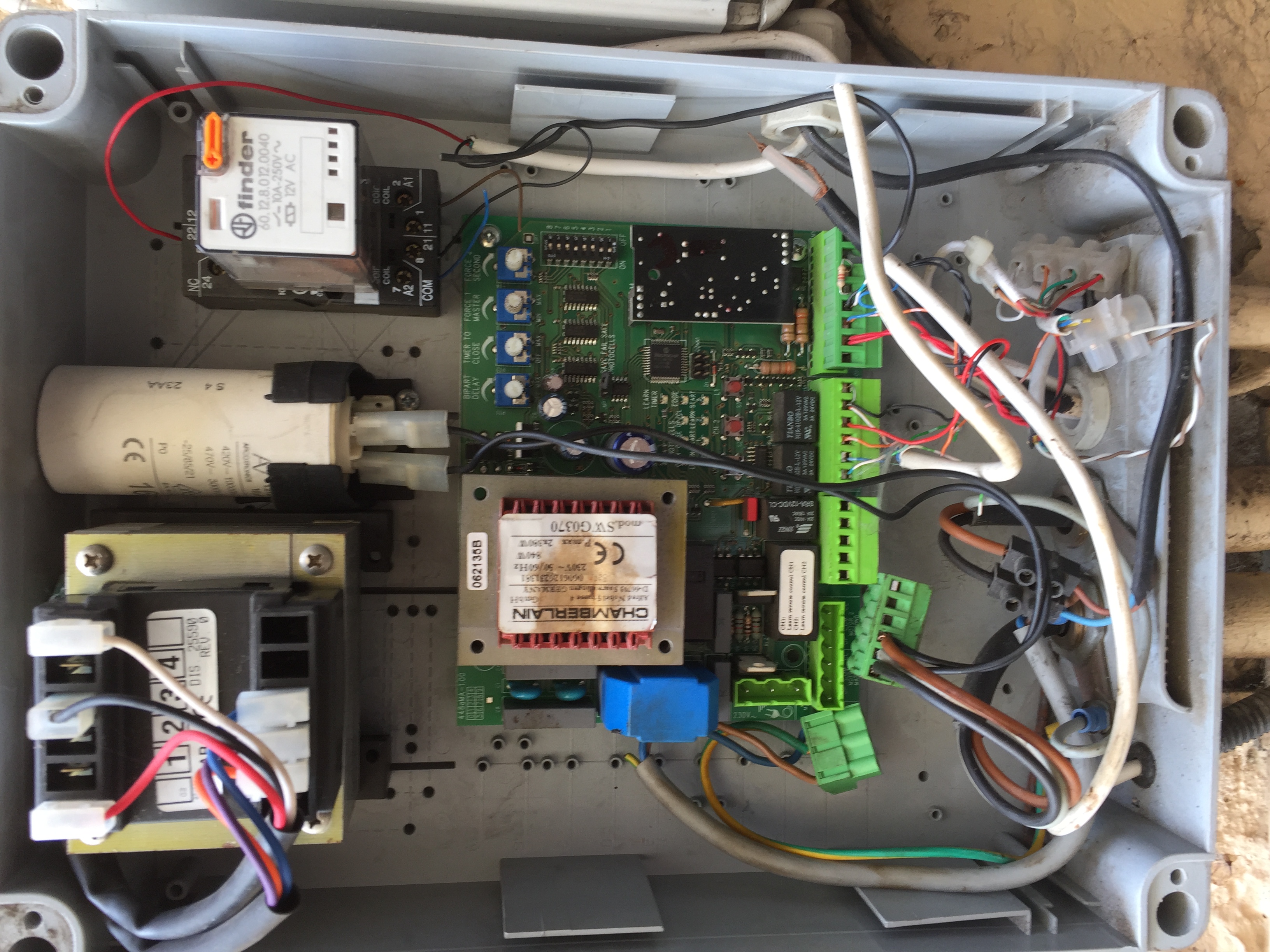

Hi Folks,
I am a postmaster in Sheffield and I have inherited an electric gate which is not working. I have replaced the Frog A, but I have no instructions for the controller pictured below.... Can anyone please tell me which controller it is as I can't find any make or reference on it!
Thank you in advance for any help.
[img][Image: sxm1yc.jpg][/img]

The control board in the picture is known as the Liftmaster CB11, i would hazard a guess that the frog motors have been used to replace the SUB300 Motors. See manual below.
http://manuals.easygates.co.uk/liftmaster-cb11/

Thanks for your reply! I think I'm going to try the capacitor, it looks like I'm going to end up with 2 frog a motors..... What is the best option for a replacement to the CB 11 board please?

This would still be the CB11 which is at £135 + vat.

It was indeed the capacitor! At least I have a spare Came Frog A motor....
